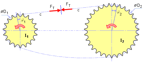

Axial, or spring-type, vibration
In the axial vibration, the chain acts like a spring connected between to rotors. This type of vibration is not readily seen, but at resonance it may be identified by increased noise. The impulse from a large cyclic load may be enough to cause damaging vibration at resonance.
Critical driver sprocket speed from polygonal effect
Critical driver sprocket speed from circumferential run-out
Critical driver sprocket speed from inaccuracy of chain link pitches
where:
n cAca
Critical driver sprocket speed from polygonal effect [rpm]
n cAcr
Critical driver sprocket speed from circumferential run-out [rpm]
n cAip
Critical driver sprocket speed from inaccuracy of chain link pitches [rpm]
z 1
Number of driver sprocket teeth [-]
c
Chain stiffness [N/m]
D 1
Pitch diameter of input sprocket [-]
D 2
Pitch diameter of output sprocket [-]
I 1
Rotating moment of inertia related to the input sprocket [kg m 2 ]
I 2
