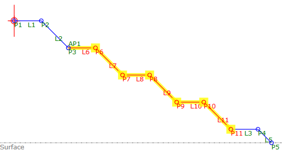

This example is designed to work in a fill situation and uses loop geometry (created from L1 and L2) to create benching.
The loop geometry has a Surface Target defined. When the Surface Target in the sample PKT file has a Preview Value of -45, the loop geometry repeats three times, and then additional links (L3 and L5) are inserted to create a partial bench that meets the surface (as shown in the illustration above). You can adjust the Preview Value of the Surface Target for the sample PKT to see how the repetition changes when the PKT encounters different surface values.
The loop repetition for this PKT is specified as 10, so it will repeat up to a maximum of 10 times. If the loop geometry repeats to its maximum number of 10 times and has not yet reached the Surface Target, then L5 will extend to the surface.

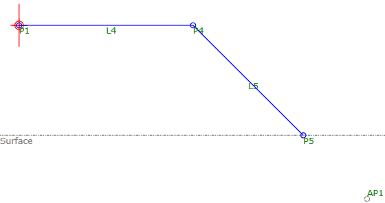

A decision has been added to the PKT file to determine whether a partial bench (used when the decision result is True) or a full bench (used when the decision result is False) is required. Auxiliary point AP1 is used to test for the condition of this decision.
The partial bench geometry, shown in the following illustration, is used if the distance to the surface is not great enough for a full bench to be used.
