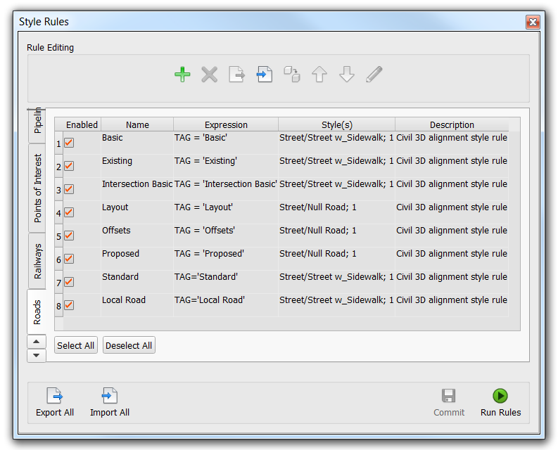

Style Rule Expressions Map Alignment Styles and Corridor Link Styles to Model Styles
InfraWorks 360 uses predefined style rules to map alignment styles to design road styles and corridor links to coverage area styles. These style rules are based on the AutoCAD Civil 3D alignment styles and link styles included in the standard templates that ship with Civil 3D. If you don't want to use these style rules, you can edit the default style rules or define new ones to specify desired alignment styles and links styles. See: To define style rules and About the Expression Editor.
The Null Road style is used to visualise the centerline of a design road created from the alignment and profile data in an AutoCAD Civil 3D corridor. Null Road style allows centerline geometry (alignment) to display in InfraWorks 360 without being hid by coverage styles used in the translation which are mapped to other link styles.
Shown below are the 8 default Road style rules. Tab to Coverage Areas to see the 20 default coverage area style rules.
Note: These style rules use the expression: TAG = 'style name '.
