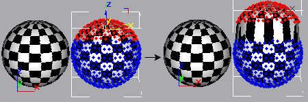

Example: Use the Preserve modifier on a geosphere:
  1. Create a GeoSphere and use Shift+Move to make a copy of it.
    Tip: If you want to see the effect of Preserve on mapping, apply a checker-mapped material to the sphere and display it in the viewports before making the copy.
  2. Convert the copy to an editable mesh.
  3. At the Vertex sub-object level, select a third of the vertices at the top of the sphere, and move them upward (as seen from the front) about one radius in distance.
    Notice the stretched edges between the moved vertices and the remaining vertices.
  4. While still at the Vertex sub-object level, apply the Preserve modifier.
  5. Click the Pick Original button, and then select the original (unedited) sphere.
    The selected vertices move back toward the sphere in an attempt to maintain the original volume and edge lengths.
  6. Turn on Invert Selection.
    The selected vertices return to their moved position, and the unselected vertices (the inverted selection) move up toward the selected vertices.
  7. Turn off Invert Selection and slowly reduce the Iterations to 0.
    The object now looks as it did before you applied Preserve.
  8. Increase Iterations to the default 25, and then increase it to approximately 75.
    The object is now almost completely spherical again.
  9. Set Iterations back to 25, and then try different Edge Lengths, Face Angles, and Volume settings. (You can restore the defaults by settings Edge Lengths to 1.0, and Face Angles and Volume to 0.3.
Steps in applying the Preserve modifier to a geosphere

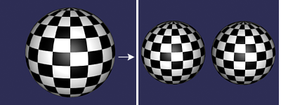

Example: Animating a preserved object:
    You can animate the Preserve parameters, but the following procedure shows you how to use Morph and Preserve together.
  1. Remove the Preserve modifier from the copied sphere, and go to object level (instead of sub-object level).
  2. With the copied (and deformed) sphere still selected, choose Create panel Compound Objects Morph to make it into a Morph object.
  3. Make sure Instance is chosen in the Pick Targets rollout.
  4. At frame 0, click Pick Target, and then select the original sphere.
  5. On the Modify panel, go to frame 100, select sphere02 in the Morph Targets list, and click Create Morph Key.
    The object now morphs from a sphere to a deformed sphere.
  6. Apply Preserve to the morph object.
  7. Click Pick Original, and select the original sphere.
    The object now morphs from the sphere to a preserved and deformed sphere. Note that because the object selection is passed up the stack, the Preserve effect is applied to the entire sphere.
  8. Choose Selected Verts Only in the Selection group.
    Now only the selected vertices are affected by Preserve. However, the morph still works.

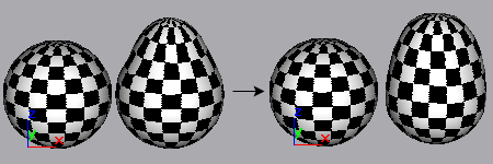

Example: Using the Selection checkboxes:
  1. Reset 3ds Max, create a box, and convert it to an editable mesh.
  2. Use Shift+Move to make a copy.
  3. Use the Modify panel to select the top four vertices in the second box. Move them upward in Z, making the copied box taller than the original.
  4. Apply Preserve, and pick the first box as the original.
    The selected vertices move down to match the original edge lengths.
  5. Set Iterations to 0 to move the vertices back up, then turn on Invert Selection, and set iterations back up to 25.
    The selected vertices stay in their original locations, but the unselected vertices move upward to restore the original edge lengths.
  6. Turn Iterations back down to 0. Turn on Apply To Whole Mesh (Invert Selection becomes unavailable), and then turn Iterations back up to 25.
    Preserve is now applied to the whole mesh. Since all vertices are affected, the top and bottom of the box approach each other.
  7. Turn off Apply To Whole Mesh.
    All vertices are translated, but maintain the same positions relative to each other.
  8. Turn off Invert Selection and turn on Selected Verts Only.
    You're back to the original effect. You can move the Iterations spinner up and down to see that you're affecting only the selected vertices.
