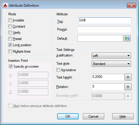

  3. Enter ATTDEF at the command prompt to insert attribute definition objects.
    Note:
    When the border drawing is inserted as a block on another drawing, attribute definition objects become attributes.
  4. Enter the Tag name SH#.
  5. Set any other attribute definition properties and values, such as text style, height, and justification.
  6. Select OK.
  7. Specify the insertion point.
  8. Repeat for each attribute definition for the title block as shown.
