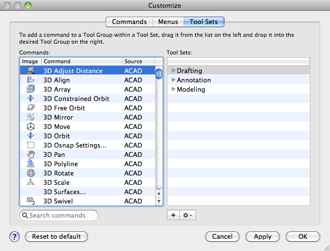

Creates and manages the tools in the Workflow palette.
The following options are displayed.
Displays a list of the standard and custom commands that can be added to menus and tool sets. You must be on the Commands tab if you want to create or edit a command.
Drag the command to the location in the menu you want it positioned and drop it. The location of the command is indicated by the horizontal bar. If you hover over a menu or sub-menu while dragging a command, the menu or sub-menu will expand after a short interval.
Filters the commands displayed in the Commands list. Click the ‘X’ in the text box to clear the current filter.
Enter a text string to control which commands are displayed in the Commands list. Only the names of the commands that contain the text string are displayed in the Commands list.
Lists the tool sets available on the Tool Sets palette. Expand a tool set to see the commands, tool groups, and drop-downs (also known as flyouts) that are assigned to the tool set.
Right-click over a tool set in the list and choose Specify Tool Set Image to display the Specify Tool Set Image dialog box. The image assigned appears next to the tool set name in the Tool Sets list on the Tool Sets palette.
Displays a menu which allows you to create a new tool set, tool group, or drop-down.
You do not add commands directly to a tool set, but to a tool group under a tool set.
Tool groups are collapsed by default, and display the commands and drop-downs above the separator in the tool group. Commands and drop-downs below the separator are hidden until the disclosure triangle for the tool group is clicked on the Tool Sets palette. Click the Lock icon on a tool group’s title bar to keep it expanded.
Displays a menu which allows you to manage the tool groups, commands, and drop-downs in a tool set.
