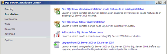

  2. Select the "Installation" option and begin the "Upgrade from SQL server 2000 or SQL Server 2005" Wizard.

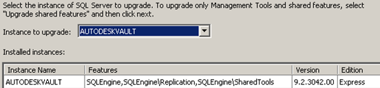

  4. Select theAutodeskVault instance to upgrade, confirm instance settings.

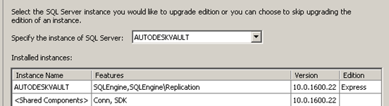

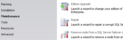

  6. Launch Setup.exe from the Full SQL 2008 installation media. Select the Maintenance option and being the Edition Upgrade wizard.
  7. Verify version and or product key for Full SQL 2008 and proceed to the Select Instance window and choose the AutodeskVault instance.
  8. Upgrade the Instance. Then, to install the SQL Management Studio, return to the "Installation" option, and be the "New SQL Server stand-alone installation, or add features to an existing installation" wizard.

  1. Select the Installation option and begin the Upgrade from SQL server 2000 or SQL Server 2005 Wizard.

  3. Select the AutodeskVault instance to upgrade, confirm instance settings.
