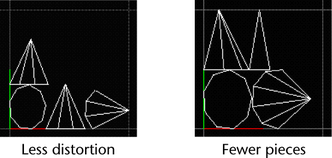

Sets the optimization type for the automatic projection.
Projects all planes equally. While this method provides the best projection for any face, you may end up with more shells. It is particularly useful if you have a symmetrical model and you want the shells of the projection to be symmetrical.
Projects each plane until the projection encounters a projection angle that is not ideal. This can result in larger shells, and fewer of them. This is the default.

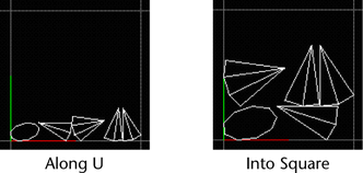

Sets where the laid out UV shells will lie in UV texture space.
Overlaps the resulting projection within the 0 to 1 UV texture space in the UV Editor. Overlap is useful when the UV texture shells need to share the same texture. When the Load Projection option is turned on, Overlap becomes the default layout.
Positions the shells along the U axis.
Positions the shells within the 0 to 1 texture space. This is the default.
Separates the resulting UV projections so they reside in a separate 0 to 1 UV space. Tile is useful when you anticipate additional editing or manipulation for the UV projections and need them to remain separated.

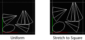

Sets how the UV shells will be scaled within UV texture space.
Performs no scaling.
Scales the shells to fit the 0 to 1 texture space without changing the aspect ratio. This is the default.
Stretches the shells to fit the 0 to 1 texture space. The shells may become distorted.

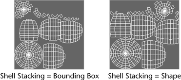

Determines how the UV shells get stacked in relation to each other when laid out in the UV Editor.
Creates a rectangular bounding box around each UV shell, then stacks the shells based on the borders of the bounding boxes. The UV shells will have more space between them when this option is set.
Stacks the UV shells based on the boundaries of each individual shell. The UV shells can be more tightly arranged to fit into any available spaces when this option is set.
