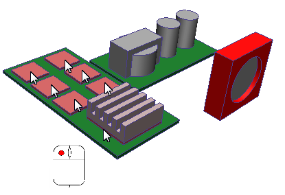

1. Select the seven chips. They are all on the same PCB:
Note: Don't forget the larger chip under the heat sink. (You may have to hide the heat sink to see it.)

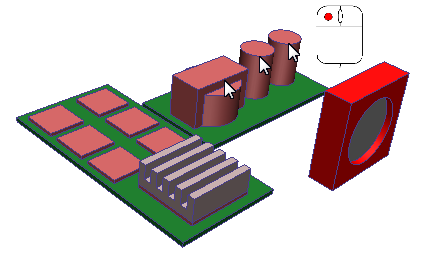

2. Select the two capacitors and the transformer.

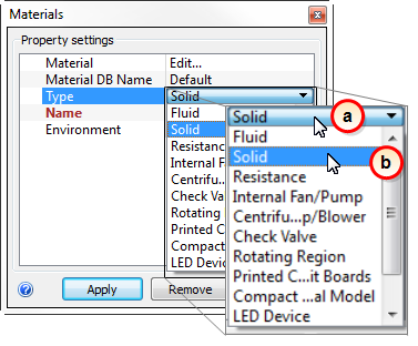

4. On the Materials quick edit dialog, select the material type:

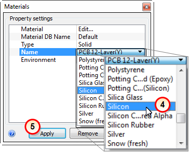

5. From the Name menu, select Silicon.
6. Click Apply.

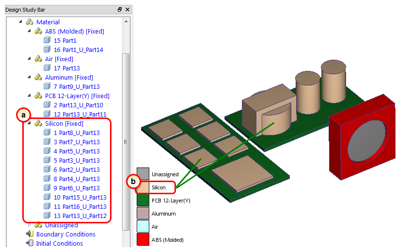

What it should look like...
7. To verify that the Silicon material is properly assigned, check the Design Study Bar and the part coloring:
