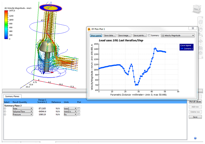

4. Learn what you didn't know (visualize the results)
Results > Result Tasks
Here is where you learn how the flow and heat move within your model. Autodesk® CFD has some great tools for visualizing and extracting results.
The type of result you need largely depends on the type of application:
Valves and other flow control devices
Flow control simulations usually show how the fluid flows through the device as well as either the pressure drop or the flow rate.
To practice with a flow control model, click here.

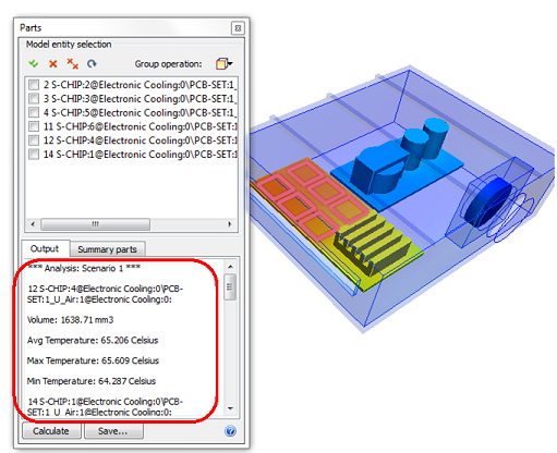

Electronics Cooling
Electronic cooling simulations typically show component temperatures and how cooling air flows through the enclosure.
To practice with an electronics cooling model, click here.

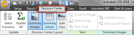

5. Iterate and Compare
A single scenario is just the first step. In many cases, you may want to try several design alternatives.
Autodesk® CFD makes it easy to transfer settings from one model to another and run variations in the same design study.
When finished, you can compare the results in the Decision Center. To open the Decision Center environment, use the Decision Center controls in the ribbon:
The Decision Center provides several ways to compare simulation results from multiple simulations:
To learn more about running and comparing Design results, click here.
