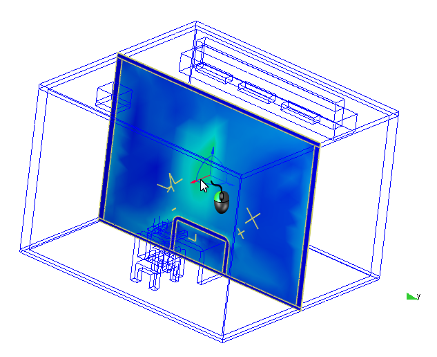

3. We need to see the flow around the occupant. To move the plane, left click on the axis in the middle of the plane, and drag it toward the occupant.
You should see this:

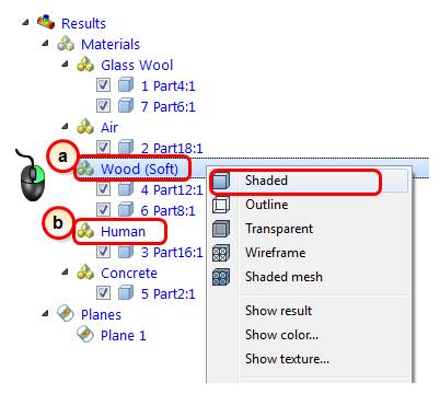

4. To improve the view, we should shade the occupant and furniture:

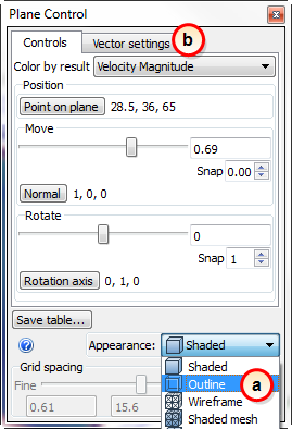

5. The colors are nice, but we need vectors to really understand the flow! To show vectors, click Results (tab) > Results Tasks (panel) > Planes, and click Edit from the Planes context menu:
On the Plane Control dialog, do the following:
On the Vector settings tab, do the following:
