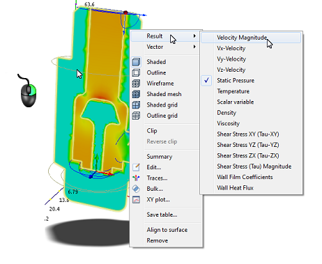

1. Let's first change the result back to Velocity Magnitude. Right click on the plane and selecting Result > Velocity Magnitude:

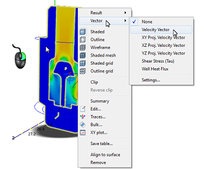

2. To show vectors, right click on the plane, click Vector, and Velocity Vector:

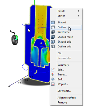

3. To see the vectors better, right click on the plane, and click Outline:
You should see this:

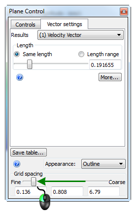

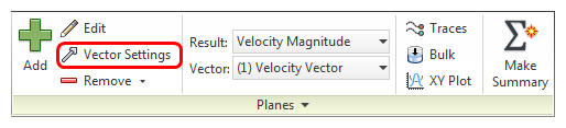

4. From the Planes context panel, click Vector Settings:
5. On the Plane Control dialog, drag the Grid spacing slider toward Fine:

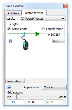

6. On the Plane Control dialog, drag the Length slider to the right:

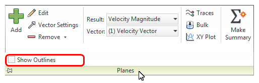

7. Click the drop down menu on the Planes context panel, and uncheck Show Outlines:
The view should look like this:
