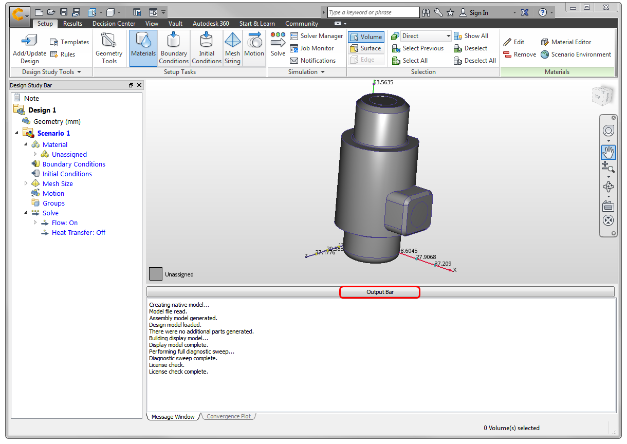

1. To open up some additional screen space, collapse the Output bar by clicking the Output Bar button:

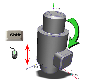

2. To rotate the model, press Shift and the middle mouse button, and move the mouse:

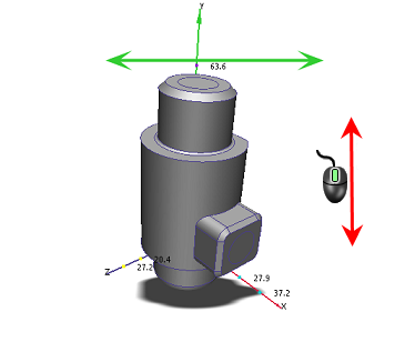

4. To pan (move), hold the middle mouse button, and move the mouse:

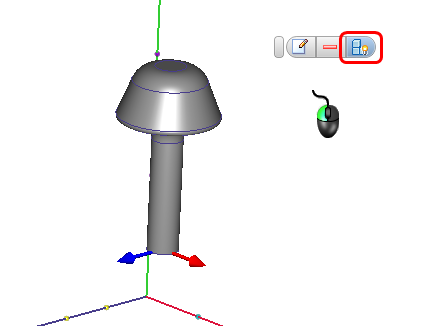

5. To hide an object, hover over it, and press Ctrl and the middle mouse button:
An alternative way to hide parts is to left click, and click the Hide icon from the toolbar:

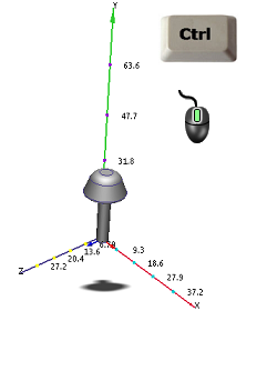

6. To show all the parts, press Ctrl and middle click off the model in the graphics window:
Alternatively, left click, and click the Show all icon:
