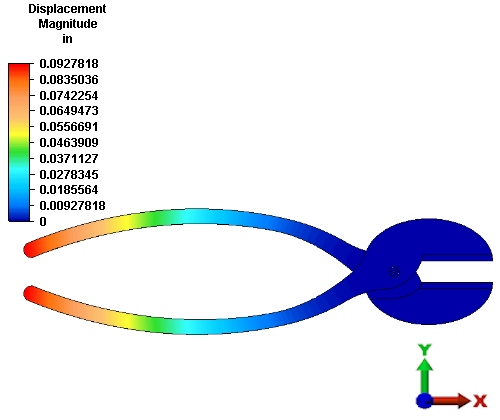

  1. Click  Analysis Analysis Run Simulation.
    After solid meshing, the analysis proceeds and the model displays in the Results environment, as shown below. By default, the displacement magnitude is presented initially.
