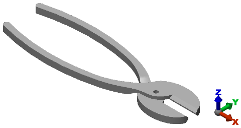

Click
Yes
when prompted about importing CAD part names. The model opens in the FEA Editor environment as shown below.
