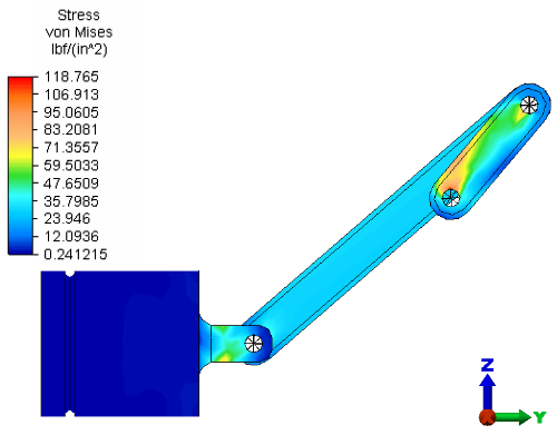

This analysis can a significant amount of time to finish, depending on your computer resources. An archive with results, Piston Results.ach, is available in your tutorial models folder. You can use this file, if desired, to review the results without having to run the analysis to completion. The Von Mises stress results at Time Step 5 are shown below.
