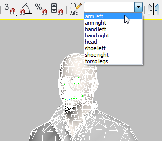

- On the main toolbar, open the Named Selection Sets drop-down list, and choose arm left from the list.
3ds Max highlights the polygons in the left arm.

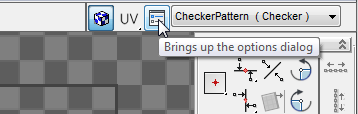

- On the Edit UVWs dialog
upper toolbar, click the
options button.

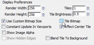

- In the Unwrap Options dialog
Display Preferences group, click to turn off Tile Bitmap, and then click OK.
This makes it easier to see the unit square of the U and V coordinates.

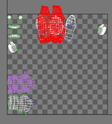

Isolate the clusters:
Before you adjust the peel of the left arm, rearrange the clusters in the Edit UVWs window.
(Move Selected Subobject) to activate it.

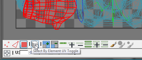

- On the first of the Edit UVWs dialog
lower toolbars, the Sub-object Selection toolbar, click
(Select by Element UV Toggle) to turn it on.
When it is on, the button shows a check mark.
- One by one, click the other clusters in the Edit UVWs window, and
move them away from the peeled sleeve. Leave the sleeve where it is.
In general, you don't want the clusters of a peeled model to overlap.
- Select the peeled left sleeve once again.
(Select by Element UV Toggle) once more to turn it off. Important: Don't neglect this step! In the next procedure you use Peel Mode, and while Peel Mode is active, Select By Element pins more vertices than you need to pin (we explain pinned vertices in the next few steps).

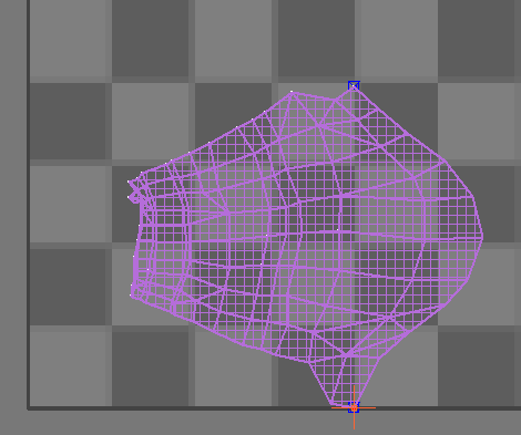

Set up pins:
- Use
(Zoom To Region) to zoom in on the peeled sleeve. Navigation tools are on the Edit UVWs dialog
second lower toolbar, the Transform/Display toolbar. They appear in the lower-right corner of the dialog.
Peel rollout, click
(Peel Mode) to turn it on. Peel Mode keeps peeling this cluster until you turn off Peel Mode, even if you select another part of the polymesh.
Sub-object Selection toolbar, verify that
(Vertex) is active. (Click the button if it isn't.)

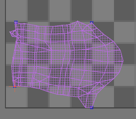

Blue boxes appear around the topmost and bottommost vertices. These boxes indicate that these two vertices are pinned.
Move one of the pinned vertices. Notice that the other pinned vertex doesn't move, but the rest of the vertices move in relation to each other. This is because Peel Mode keeps peeling the cluster while you move the pins.
Peel Mode spreads the UVS among pinned vertices on the cluster. Because at least two pins are needed, the Unwrap UVW modifier chooses two pins by default. If you move an unpinned vertex, Auto-Pin Moved Vertices automatically pins it.
Tip: If moving a pinned vertex moves the entire cluster, deselect all vertices and then click the vertex you want to move.
- Move the two pinned vertices so they align better with the checker grid.

Finish the layout of the left arm:
Move individual vertices so the layout of the sleeve is roughly rectangular, and better aligned with the checker grid. Important: Make sure that in the Pins group,
(Auto-Pin Moved Vertices) is turned on. When this option is off, you can move only vertices that are already pinned.
These adjustments don't have to be precise. Look at the model in the viewport to see that the peeled sleeve is mapped fairly evenly, with no obvious distortion.

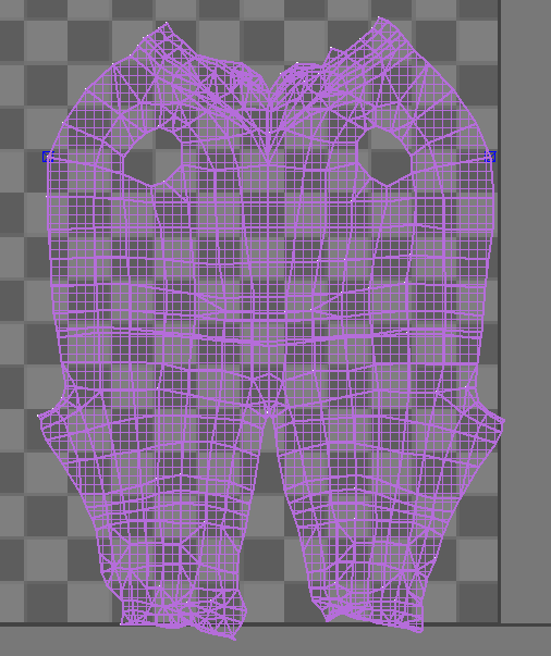

3ds Max peels the torso and legs cluster and flattens it.

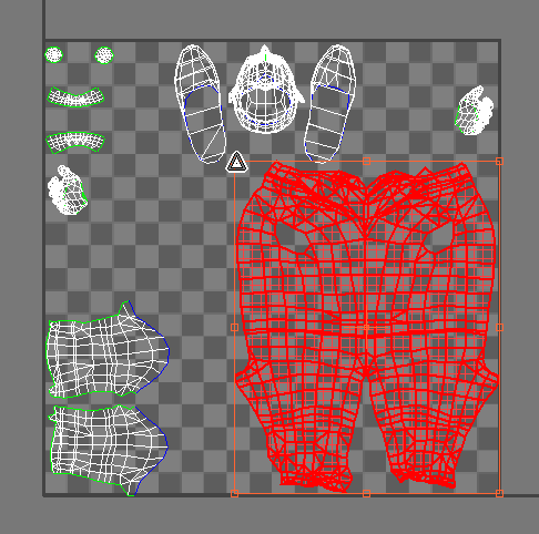

- Use the
(Freeform Mode) tool to rotate the cluster and place it in the empty area at the lower right of the Edit UVWs window.

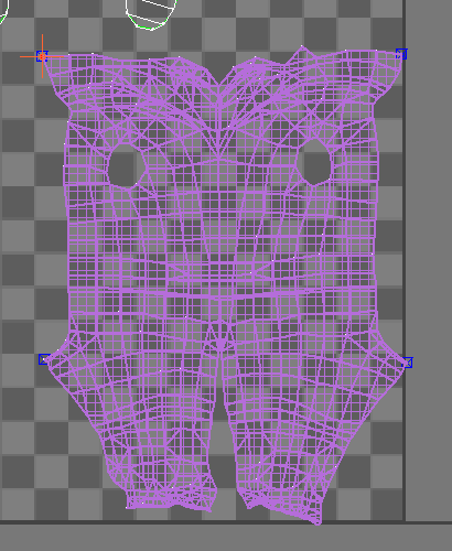

- Turn on
(Peel Mode), then click
(Vertex) to go to the Vertex sub-object level.

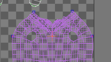

- Activate

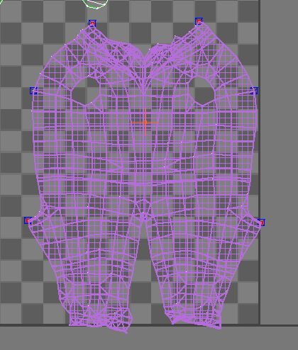

(Move Selected Subobject) again. For the torso legs cluster, the default pinned vertices are either side of the armholes. This is not the best solution.
- For this cluster, click and Ctrl+click to select four other points to pin: The two at the very top, which correspond to the back of the collar, and the two at the widest point of the legs, which correspond to the crotch of the pants where the inseam meets the back seam. When you have selected these four points, click
(Pin Selected).
Picking new pins will Peel again, changing the shape a little to spread UVs between the pins.

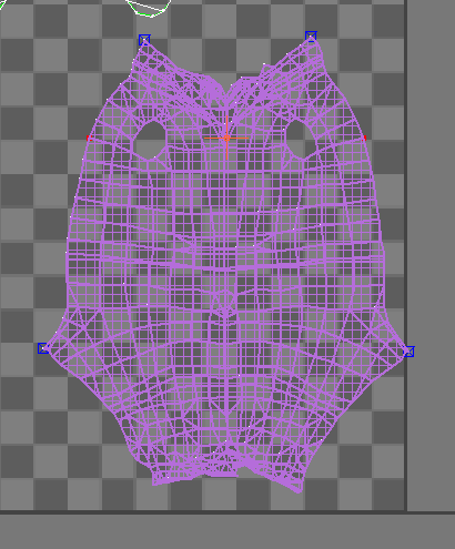

- Click and Ctrl+click to select the default pins on either side of the armholes.
- On the Peel rollout, click
(Unpin Selected).
Move the two pinned points at the collar farther apart, to spread the cluster more evenly across the checker pattern.

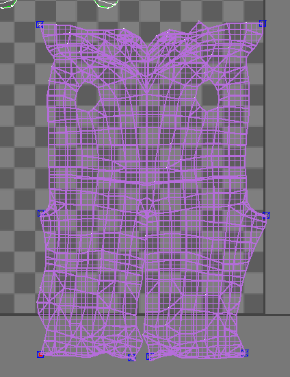

- Also
move the points at the corners of the cuffs of the pants, spreading them apart a bit and making the distribution more even. Don't worry that the cluster extends beyond the unit square.

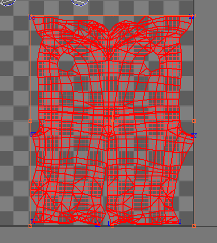

- As before, check your work in the viewport to see that the texturing is even.
- Finally, turn off
(Peel Mode), activate
(Freeform Mode), and click
(Polygon) to return to the Polygon sub-object level. Select the torsolegs cluster once more, and scale it so it fits within the unit square.
