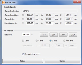

Alternatively, parts can be rotated by a specific angle around one of the three axes. In the Rotate parts dialog, you see the current selection, its position and size are shown, as well as the rotation center. Now you can either click on a standard angle (45°, 90°, 180°, or 270°) or insert an angle in the empty field. Below, define the X-, Y- or Z- or your own free axis as axis of rotation.
The dialog box for rotating parts
If the box Keep window open is ticked, you can apply the changes by Rotate, the dialog will stay open and you immediately can rotate the part again.
