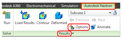

Click Autodesk Nastran Results Options.

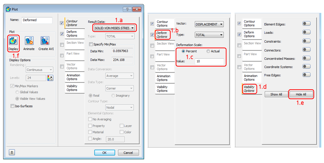

The Plot dialog box appears. Refer to Figure 1.a – 1.f for the following six steps.
Figure 1.a – 1.f
The initial Result Data setting for linear static stress analyses is SOLID VON MISES STRESS. This is the plot we will look at first. Verify that this is the selected result; but change the selection if necessary.
Click on the Deform Options tab of the Plot dialog box.
The default deformation is scaled to 10 percent of the model size by default. We will keep this setting so that the deformed shape is clearly visible.
Tip: For large deformation nonlinear analyses, especially when there is free-body motion of one or more parts, it is best to show the actual displacement. In addition, when comparing multiple analysis subcases, or when creating a Multiset Animation, a fixed multiplier of the actual displacement produces the best visual results.
Click on the Visibility Options tab of the Plot dialog box.
Click Hide All. This action produces a cleaner contour plot, without mesh lines or constraint and load glyphs.

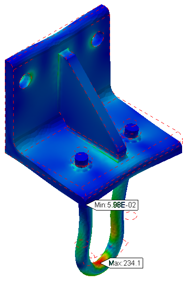

Click Display. Your Von Mises Stress results should be similar to the following image:

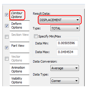

Click on the Contour Options tab of the Plot dialog box.

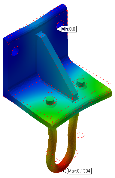

From the Result Data pull-down menu, choose DISPLACEMENT. Your displacement contour plot should be similar to the following image:
