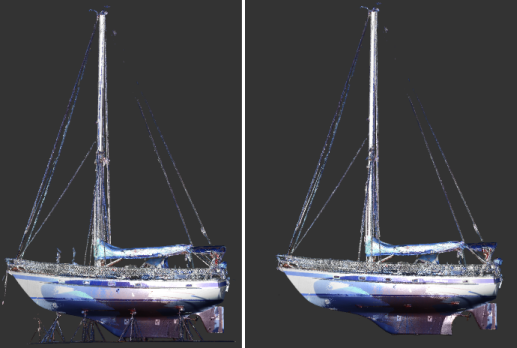

Clipping provides a way to hide extraneous portions of the point cloud without permanently removing the points. For example, you can use clipping to trim away people and vehicles picked up in the laser scan. In the following illustration, multiple clipping areas were used to remove the boat stands holding up the boat.
Like creating a Scan Region, the clipping action originates with accurate selection. Once a selection has been made, you can specify whether points are clipped inside or outside the clipping boundary, depending on whether you want to remove something from the scene or isolate it.

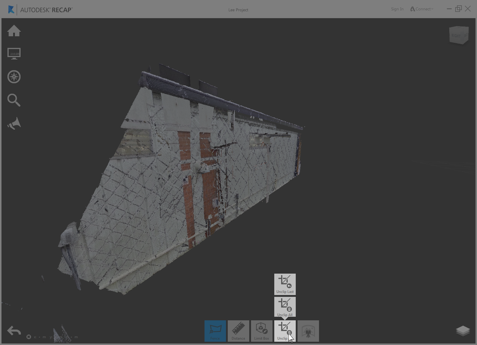

Remove clip boundaries to restore display of the clipped points. In point clouds with more than one clip boundary, you can choose to remove all boundaries, or step back chronologically to remove boundaries one at a time.

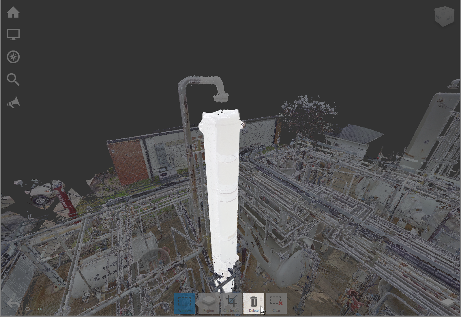

Delete Points
You can also permanently remove points from the scan file by directly selecting them or by deleted a Scan Region with cleaned points. This is a good way to clean up extraneous points that are outside the area of interest. If you need to restore points that you did not want to remove, click the Undo button or Ctrl+ Z immediately after the Delete operation.
Note: Be cautious when deleting points. Deletion permanently removes the points from the scan file. They can only be restored by using Undo immediately after you delete them or else you will have to restore all points collectively deleted from the project!

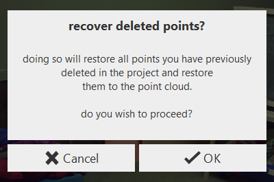

Recover Deleted Points

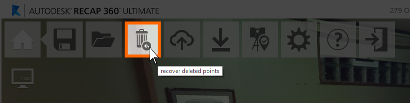

In addition to the standard "Undo" action that can be used directly after performing a delete operation in a project, you can also "recover" all deleted points. This is available from within the Home flyout of the main menu.
Once confirmed, any points previously deleted will be added back to the project.
Note: This does not include points that have been removed through the "Shrink" optimization described in the next section.
