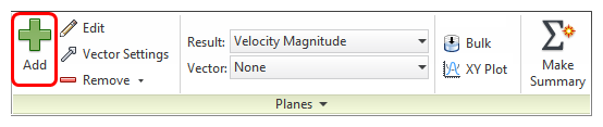

Off-model: Click
Add in the
Planes context panel. Alternatively, right click on the
Planes branch of the Design Study bar, and click
Add plane:

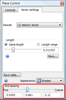

To control the vector density
- Drag the
Grid spacing slider on the
Vector Settings dialog.
- To specify a finer or coarser grid spacing beyond the slider range, key in the values in the field adjacent to the slider.

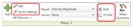

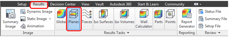

Note: Ensure
Planes is selected on the
Results Tasks panel.

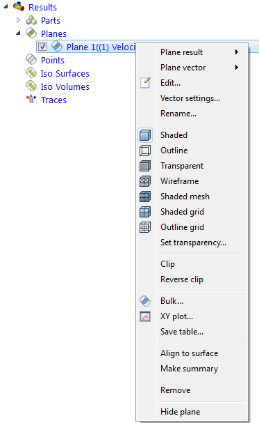

On-model Method 1: Left click on the Plane, and click the context toolbar icon.
a. Settings (Controls)
b. Vector settings
c. Bulk
d. XY Plot

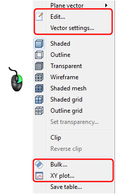

On-model Method 2: Right click on the Plane, and select from the menu.
Off-model: Click the icon in the
- Off-model Method 2: Right click on the Plane from the Planes branch of the Design Study bar.

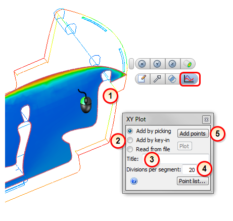

Create XY Plots
Create an XY plot by selecting points on a cutting surface, by entering point coordinates, or with points saved from a previous plot. The maximum number of points in an xy plot is 500.
Step 1: Create a Results Plane and open the XY Plot dialog
Step 2: Select the method of point selection:
Add by Picking
- Click Add points.
- Click on locations on the cutting plane through which the plot will pass. The Point List Region displays points.
- A minimum of two points is required.
Add by Key In
- Specify X, Y, and Z coordinates separated by a comma in the field. (Do not use brackets or parentheses.)
- Click Add.
Read from File
- To save XY plot point locations to a file, click Save Points.
- To create a new XY plot using saved point locations, select Read from File. Click Browse, and select the desired xyp file.
Note: You can use saved point locations to create a plot on a different scenario.
Step 3: Enter a Title
- Specify a Title for the plot. This is optional. If no title is entered, the plot is labeled "Untitled."
Step 4: Change the Number of Divisions
- The default number of divisions between every point is 20.
- Modify this value to change the plot resolution.
Note: The number of divisions must between 2 and 500.
Step 5: Create the Plot
- To create the plot, click Plot.

To change the number of points saved to the table, modify the
Grid spacing resolution on the Vector settings tab:

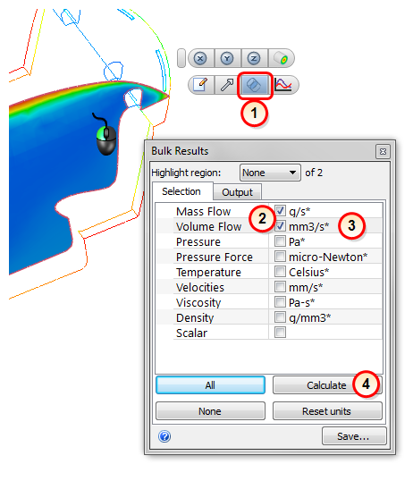

Using a Plane to Measure Bulk Values
The Bulk Calculator quickly calculates and shows bulk-weighted results on a Results Plane. Bulk (mass-weighted) results are automatically updated as the active Plane is moved.
Workflow
Start by positioning the Results Plane in the desired location.
- Open the Bulk dialog.
- Select the desired quantities for bulk calculation.
- Change the units of the output quantity with the adjacent menu list.
- Click the Calculate button.
- The bulk results are written to the Output tab.
To save bulk data when animating a transient analysis, click the Save button. The results from the active time steps will be saved to an Excel csv file.
Notes
- Pressure is static gage pressure.
- Volume Flow Rate is the product of velocity and area.
- Pressure Force is the pressure integrated over an area (This is an area-weighted pressure. The pressure value produces a mass-weighted pressure value).
- Velocity components are displayed by selecting Velocities.
