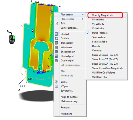

1. Let's first change the result back to Velocity Magnitude. Right click on the plane and selecting Plane result > Velocity Magnitude:

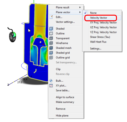

2. To show vectors, right click on the plane, click Plane vector, and Velocity Vector:

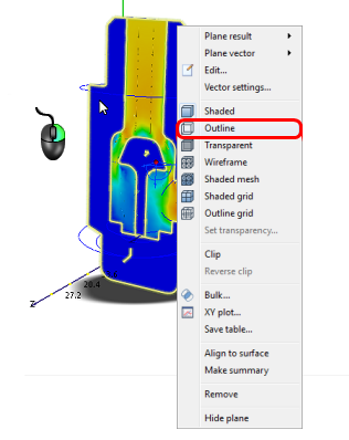

3. To see the vectors better, right click on the plane, and click Outline:
You should see this:
Note: There are not enough vectors to see much, yet...

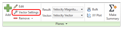

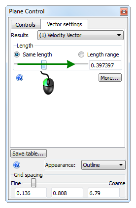

4. From the Planes context panel, click Vector Settings:

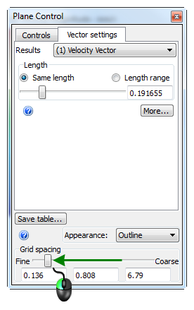

5. On the Plane Control dialog, drag the Grid spacing slider toward Fine:
Note: That's better, but we should make the vectors bigger:
6. On the Plane Control dialog, drag the Length slider to the right:

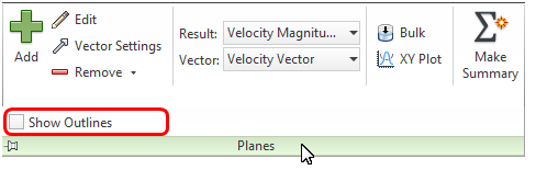

Note: We should hide the outline around the plane...
7. Click the drop down menu on the Planes context panel, and uncheck Show Outlines:
The view should look like this:
