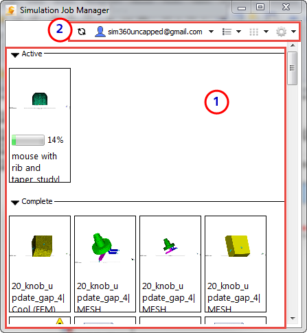

1. Job view
The Job View area is where you can see all the jobs you have launched. The area is divided into Active and Complete jobs. Hover over the thumbnail to see job details. Right-click on a job to see additional information.
2. Toolbar
The toolbar is used to set up and customize the Simulation Job Manager. You can change from thumbnail view to list view to see additional job details, sort the jobs according to a variety of characteristics, or change the location of your temporary file transfer folder
