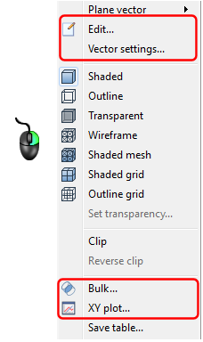

		  On-model Method 1: Left click on the Plane, and click the context toolbar icon.
				   a. Settings (Controls)
				  b. Vector settings
				  c. Bulk
				  d. XY Plot
		  On-model Method 2: Right click on the Plane, and select from the menu.

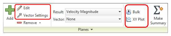

		  Off-model: Click the icon in the
		  Planes context panel.

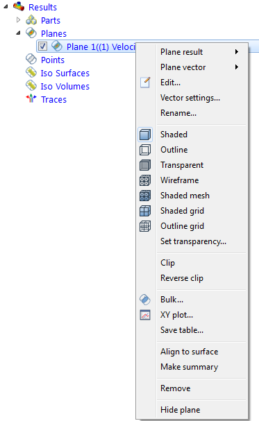

	 - Off-model Method 2: Right click on the Plane from the Planes branch of the Design Study bar.
