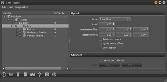

We simplified the Tracking module. You can now add and configure servers, tracker devices, and bodies all in one view. Manual calculations are no longer needed. You can set local offsets. You can run diagnostics connection tests to make sure the communications are working.
Choose .
For details, see To Set Up a Tracking Configuration.

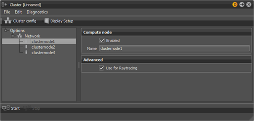

In VRED Professional 2016 SR1 we introduced a newly designed HPC Cluster module that provides better scalability, and better monitoring and diagnosis capabilities. Designed to leverage large clusters, the module provides improved load balancing and performs two to three times faster. The bigger the cluster the bigger the gains compared to previous versions of VRED.
The Raytracing Cluster is located under .
In this release, we added a new Display Cluster that leverages the technological innovations introduced in VRED Professional 2016 SR1. The Display Cluster enables high performance raytracing presentations in Powerwall or Cave environments, for ultra realistic immersion. You can now set up each cluster configuration using an arbitrary combination of nodes for raytracing calculations and display options.
In a realtime raytracing cluster scenario, each display cluster node also performs raytracing calculations including load balancing, and thus requires a Render Node license. Because of this requirement, display clustering with realtime raytracing is not possible in VRED Design.
The nodes for OpenGL display clustering are free of licensing for both VRED Professional and VRED Design.
Set up the Display Cluster from the Cluster dialog box. Click Display Setup.

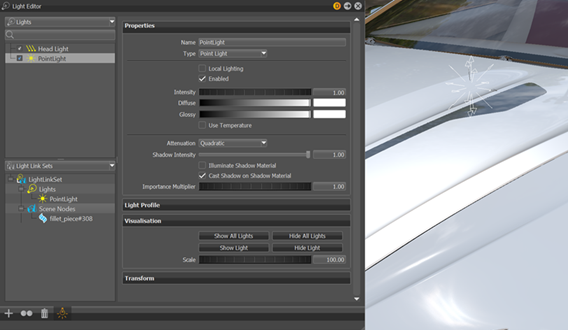

There is now only one node in the scenegraph which represents the positioning and orientation of the light. Local lighting is now done by light linking. You no longer need to place the light sources in certain places of the scenegraph.
To set up a light link, create a new set and assign the geometry nodes and the lights to the set.
When you open an scene from VRED 2016 and earlier in VRED 2017, the lights are converted to the new lighting.

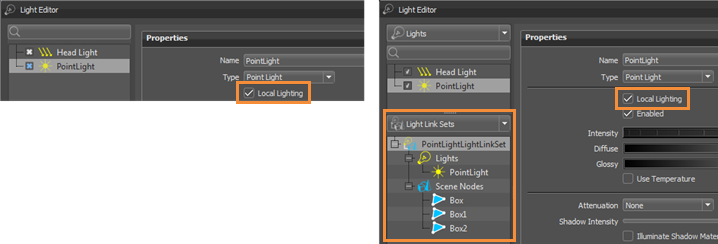

The following example shows a scene with a point light that is locally lighting three boxes. The images on the left show the lighting setup in VRED 2016, the images on the right show how the lighting setup is transferred when you open the same file in VRED 2017.
Left: Scenegraph VRED 2016, Right: Scenegraph VRED 2017
Left: Light Editor VRED 2016, Right: Light Editor VRED 2017

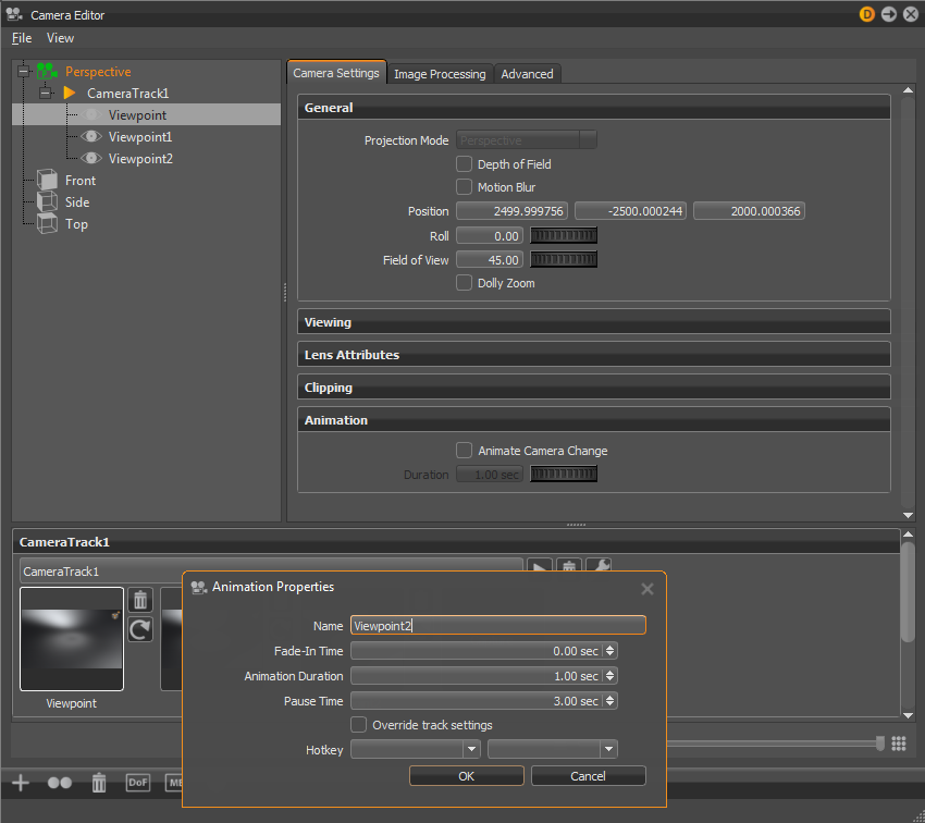

Set the hotkey in the Animation Properties dialog box for the Viewpoint.
