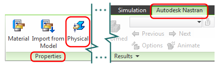

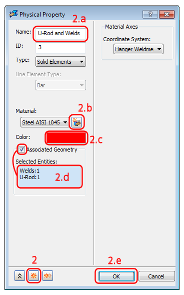

Properties
Physical.

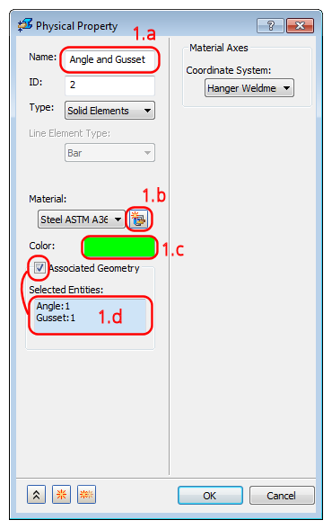

The Physical Property dialog box appears. The default element Type is Solid Elements, which is appropriate for this tutorial model.

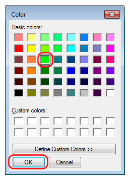

Figure 1.a – 1.d
Consult Figure 1.b.i – 1.b.vi for the following six steps.

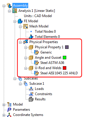

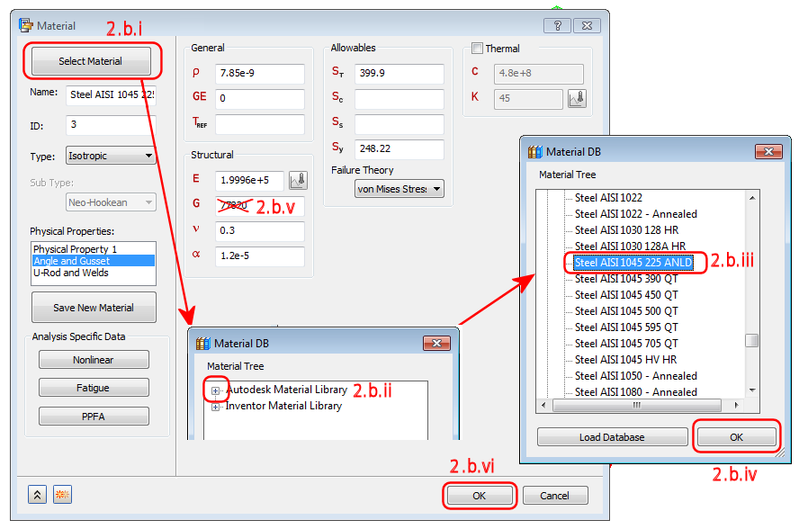

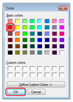

Figure 2 – 2.e
(Consult Figure 2.b.i – 2.b.vi for the following six steps.)
