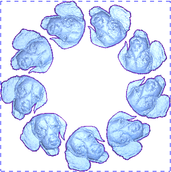

    For example, copying a piece of relief clipart nine times at 40 degree intervals looks as follows:
    Before
    After
