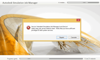

When you install on a Windows 8.1 platform, you may see the following error message:
To resolve this problem, install the following Windows updates in the following order:
  • clearcompressionflag.exe
  • KB2919355
  • KB2932046
  • KB2959977
  • KB2937592
  • KB2938439
  • KB2934018
If KB2919355 fails to install, install KB2919442 first, then try again with KB2919355 and the rest of the updates in the list.
