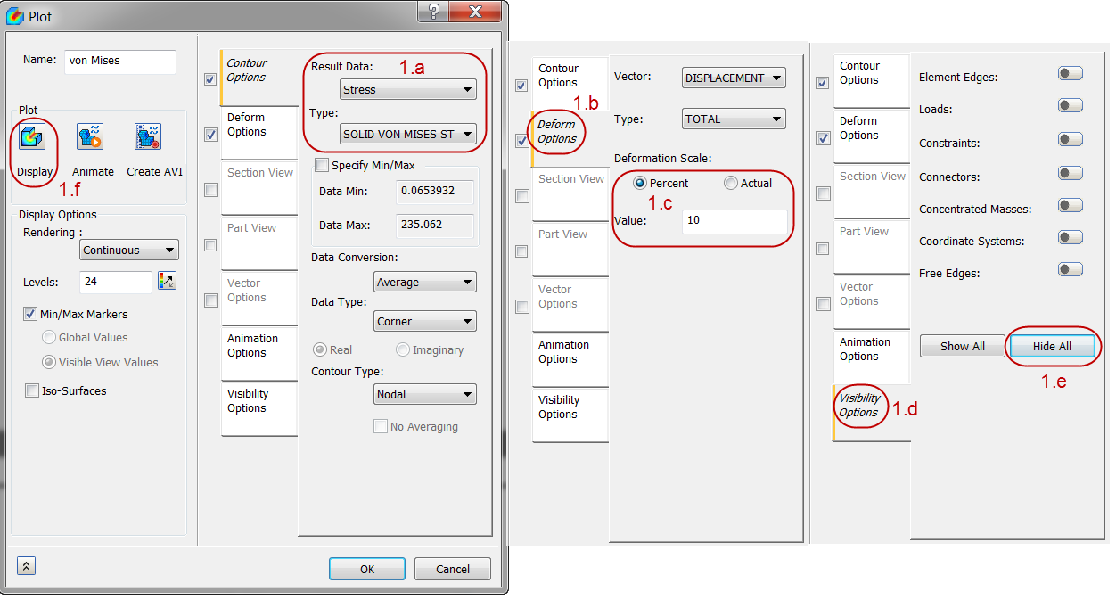

Click
Autodesk Nastran Results Result Options.
The
Plot
dialog box appears. Refer to
Figure 1.a – 1.f
for the following six steps.
Figure 1.a – 1.f
Ensure that
Result Data is set to
Stress, and
Type is
SOLID VON MISES STRESS. This is the plot we will look at first.
Click on the
Deform Options tab of the
Plot
dialog box.
The default deformation is scaled to 10 percent of the model size by default. We will keep this setting so that the deformed shape is clearly visible.
Tip: For large deformation nonlinear analyses, especially when there is free-body motion of one or more parts, it is best to show the actual displacement. In addition, when comparing multiple analysis subcases, or when creating a
Multiset Animation, a fixed multiplier of the actual displacement produces the best visual results.
Click on the
Visibility Options tab of the
Plot
dialog box.
Click
Hide All. This action produces a cleaner contour plot, without mesh lines or constraint and load glyphs.

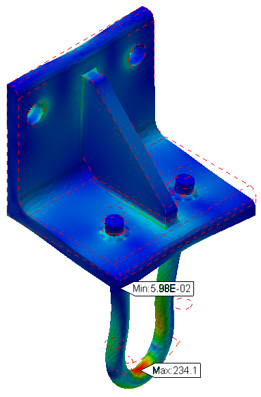

On the left side of the
Plot dialog box, click
Display. Your Von Mises Stress results should be similar to the following image:

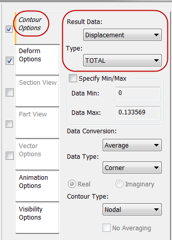

Click on the
Contour Options tab of the
Plot
dialog box.

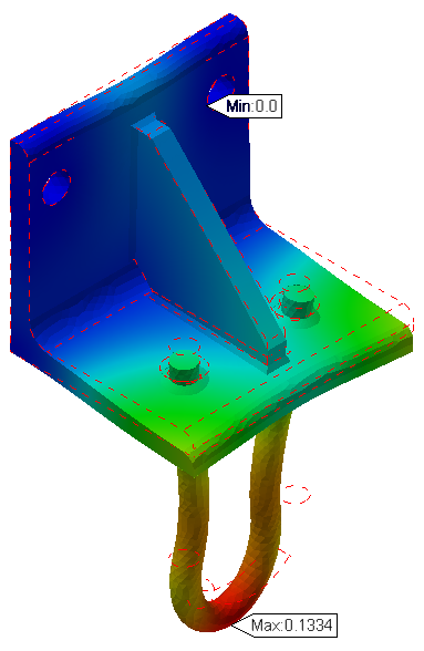

From the
Result Data pull-down menu, choose
Displacement, and set
Type to
TOTAL. Your displacement contour plot should be similar to the following image:
