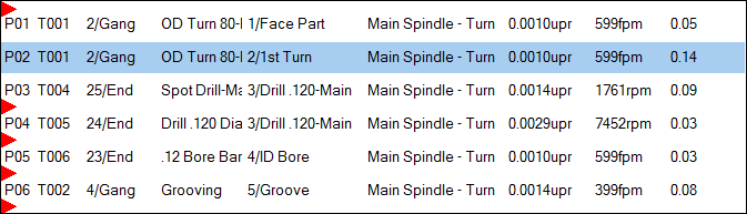

By default, PartMaker orders the processes in the Process Table according to the sequence in which you programmed the part. It starts by creating processes for all the part features in the first Face window you created, before moving onto the next Face window you created and so on.

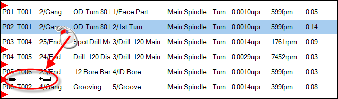

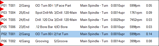

If the default order of processes does not reflect the sequence in which you want the part to be machined, you can reorder processes as follows:
To select a group of consecutive processes, click the first process in the group hold down the Shift key, and then click the last process in the group.
To select non-consecutive processes, hold down the Ctrl key, and then click each process you want to select.
Use Ctrl+Z if you drop process(es) in the wrong location and want to undo this action.
