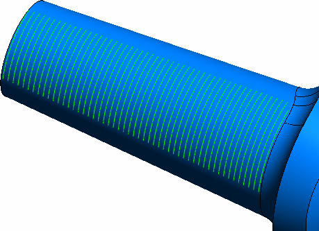

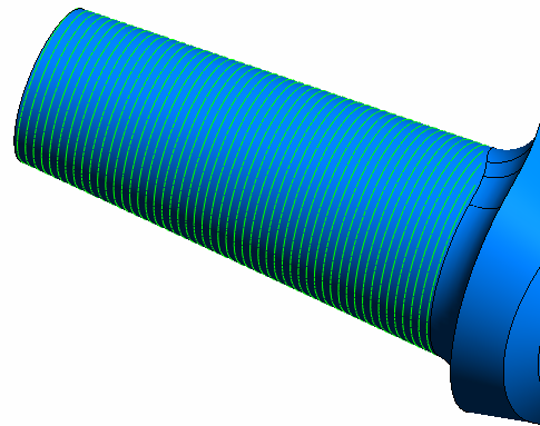

Use the Spine finishing page to project a tubular pattern onto the model, which is then machined. The curve that is used as the center of this tube (the focus of the pattern) is known as a Spine curve.
Pattern
Style — Select a style to define the shape of the pattern.
Ordering — Select how successive toolpath segment are machined.
For more information, see Ordering examples.
Direction — Select whether the direction is Clockwise or Counter-Clockwise when using a Style of Spiral.
Angular limits — Specify the angular limits of the toolpath in the Start and End fields.
and an End of 360
and an End of 90
This option is available only if you select a Style of Circular or Linear.
and an End of 360
and an End of 90
Tolerance — Enter a value to determine how accurately the toolpath follows the contours of the model.
Thickness — Enter the amount of material to be left on the stock within tolerance. Thickness is applied as an offset to the tool in all directions:
Stepover — Enter the distance between successive machining passes.
Angular stepover — Enter the angle between consecutive passes.
