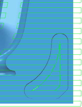

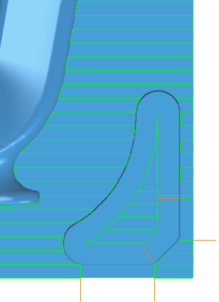

Allow tool outside flat — Select this option to allow the tool to go outside the flat area. This alleviates the problem of running the tool along a sharp edge.
Select Allow tool outside flat:
Deselect Allow tool outside flat

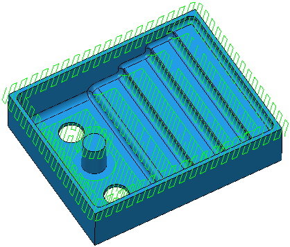

Fixed direction — Select to specify the angle of passes in the Angle field. When deselected, PartMaker automatically calculates the most appropriate angle.
Select Fixed direction
Enter an Angle of 0:

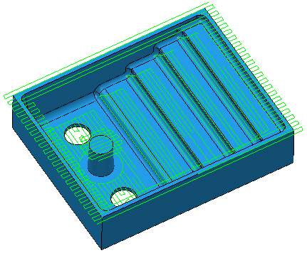

Enter an Angle of 45:
