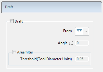

Use the Draft page to add a draft angle to a vertical pass.
Draft — Select this option to enter a draft angle.
From — Select the location of the toolpath relative to the curve:
— The draft angle is taken from the top cut.
— The draft angle is taken from the bottom cut.
Angle — Enter the angle of the draft, relative to the tool axis.
Area Filter — Select to ignore areas smaller than the Threshold value.
