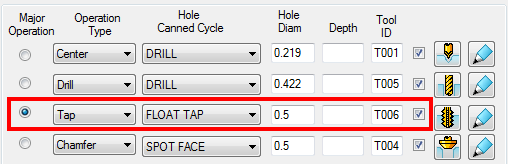

Operation Type — These field show the type of operations included in the cycle. Each cycle can consist of up to 10 operations. Select the Major Operation option next to the operation you want to be the major operation in the cycle. For example:
