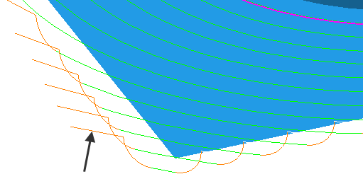

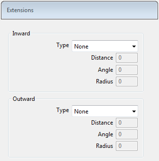

Use the Extensions page to add another lead to the existing ones.
Inward — Use these settings to add an additional Lead in before the existing one.
Extension of Straight with a Distance of 10, and an Angle of 0. Leads of Surface normal arc.
With a Distance of 10.
Extension
of
Straight with a
Distance of
10, and an
Angle
of
0.
Leads of
Surface normal arc.
With an
Angle of
0
With an
Angle of
90

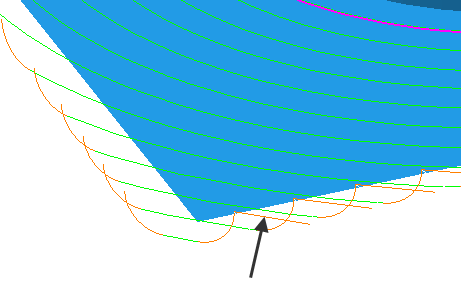

Outward — Use these settings to add an additional Lead out before the existing one.
Extension
of
Straight with a
Distance of
10, and an
Angle
of
0.
Leads of
Surface normal arc.
With an
Angle of
0
With an
Angle of
90
