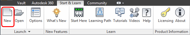

1. Start Autodesk® CFD, and click New.

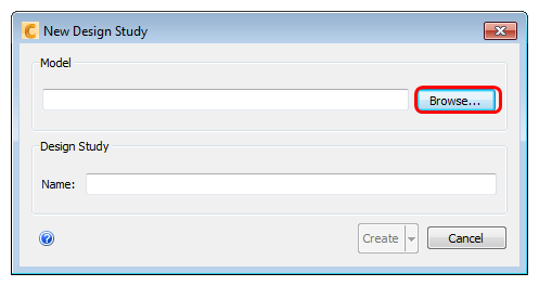

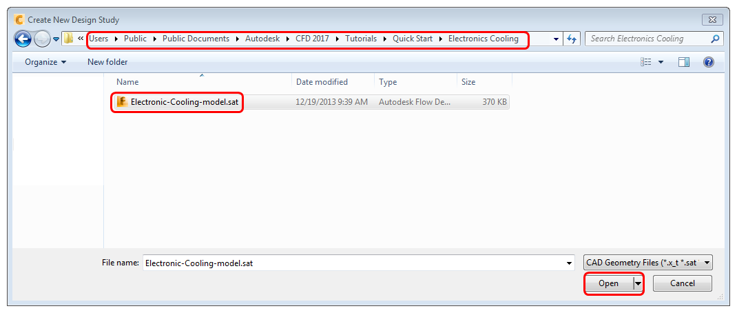

2. On the New Design Study dialog, click Browse...
3. Navigate to C:\Users\Public\Public Documents\Autodesk\CFD 2018\Tutorials\Quick Start\Electronics Cooling, and select Electronic-Cooling-model.sat. Click Open.

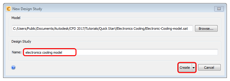

4. On the New Design Study dialog, enter the design study Name, make sure the button option is set to Create, and click Create:

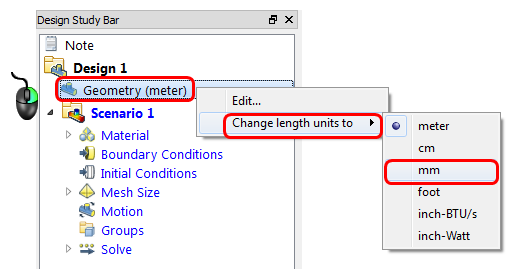

6. The geometry imports in units of meters, but we need to convert it to mm. To do this:

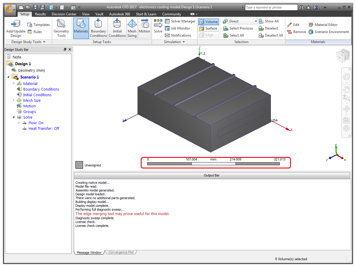

What it should look like:
Autodesk® CFD starts, and you should see the model. Note the dimension values on the scale:
