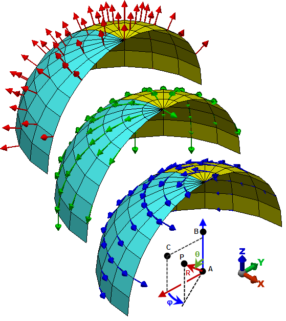

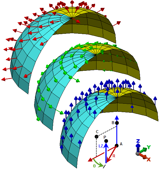

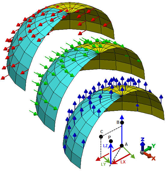

Rectangular 2(a) Local X Local Y Local Z
Cylindrical 2(b) Radial Tangential (ϑ) Axial (Local Z)
Spherical 2(c) Radial Polar (ϑ) Tangential (φ)
(a) Rectangular Coordinate System
(b) Cylindrical Coordinate System
(c) Spherical Coordinate System
Figure 2: Local Directions for Coordinate Systems
In each figure, the direction of local X, local Y, and local Z are shown on the three hemispheres from top left to bottom right. The local axes are shown in the bottom right hemisphere only. (All hemispheres are defined with the local coordinates at the centers.) The three points A, B, C that define the local coordinate system are entered using global X, Y, Z coordinates. Then an arbitrary point P is shown with its local coordinates. Although the coordinates of points cannot be entered using local coordinates, extending the coordinates to the point will show the direction of the loads and constraints, as shown by the nodal forces in each of the three hemispheres.

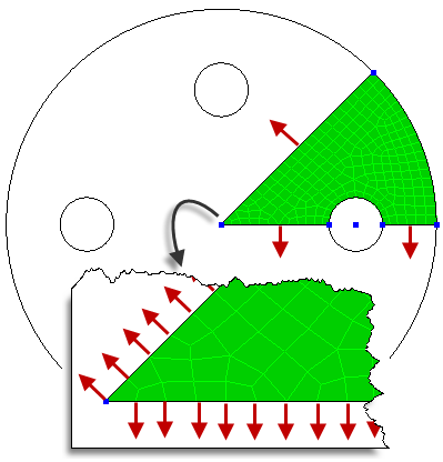

  • Also, imagine a wedge-shaped model that represents a 1/8 section of a full disk (background portion of figure below). The edges are assigned to a cylindrical coordinate system, and symmetry boundary conditions are added to the edges so that the nodes cannot move in the tangential direction (red arrows in figure). The node at the center point is not restrained in two tangential directions as are required by the symmetry condition; it is only restrained in one direction (see inset in figure, which shows the tangential direction at all the nodes). You must place a radial and tangential constraint on this node.
