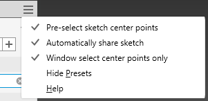

- Optional - check the panel menu to see if the options you want are active. The two options are:
Pre-select sketch center points - checking this option causes all unused sketch center points, in the active sketch, to automatically be selected for use by the Hole command, populating each center point with a hole. Use CTRL+click to remove center points from the selection set. Uncheck the option to disable pre-selection.
- Automatically share sketch - when using the Hole command, if unused sketch center points exist when you click
(Create new hole), the sketch is automatically shared and visible for use with creating the next Hole. If you do not use the sketch for the next hole or click Cancel or Esc, the sketch will be unshared. You can share a sketch manually by right-clicking the sketch browser node and clicking Share Sketch. This option is available only in the Part environment.
- Window select center points only - by default this setting is
ON and window select will capture only center point objects. If you want to select any type of point object, this is a legacy behavior, click to turn the setting
OFF.
