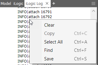

iLogic now provides a type of PRINT statement that can be used in rules. This new functionality, called iLogic Logging, uses new iLogic functions to send log messages to a new Inventor panel and also to a log file. In addition, there's a new automatic rule tracing mechanism. Rule tracing helps you to visualize when and why a rule is run.
Overview
To generate iLogic logs:
Managing Log Messages in the iLogic Log Panel
The active log level controls which logging statements are actually logged. Start by setting the log level to Debug and including logger.debug("message") statements into your rules. Once you've finished debugging and you no longer need the Debug messages, then change the active log level to Info or to another level lower in the list. You don’t need to remove the logger.Debug statements from your rules. Subsequently, only Info, Warn, Error or Fatal messages will appear. This same behavior applies to all log levels. For example, if you change the level to Info, and the log panel is getting cluttered with Info messages, change the log level to Warn. The Info messages will stop appearing, and only the Warn, Error, Fatal messages will display. Setting the active log level allows you to display only the types of messages you need.
Navigation Links
After you clear messages from the panel, navigation links display at the top of the panel if older messages are available. The iLogic Log panel is limited to displaying 20,000 messages at one time. When over 20,000 messages are entered, navigation links at the bottom of the panel allow you access messages created after reaching the 20,000 limit.

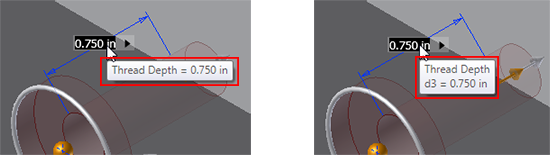

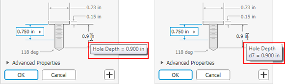

Value Fields Display Parameter Names in Tooltips
Value fields now display the parameter name in the tooltip. When you pause the cursor over the parameter name displays with the value.
Here are some examples comparing prior releases (left image) with 2019.1 (right image):
Dialog

In-canvas

Value Edit Feedback
For the Hole command, when a value is invalid, for example, the specified thread length is larger than hole depth, the value color turns red and the tooltip reports the value is invalid when you're entering the value. This allows you to immediately correct the value or locate another value that needs editing for this one to become valid. When a value is valid, the value color is black.
For more information, see To Create Holes
