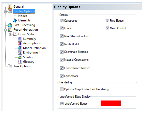

  • Display Options:
    • Display – All options activated except Free Edges
    • Undeformed Edge Display Undeformed Edges – Activated
    • Undeformed Edge Display Color – Red

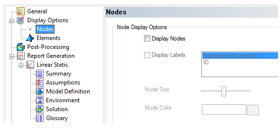

  • Display Options Nodes:
    • Nodes Node Display Options – Both options deactivated

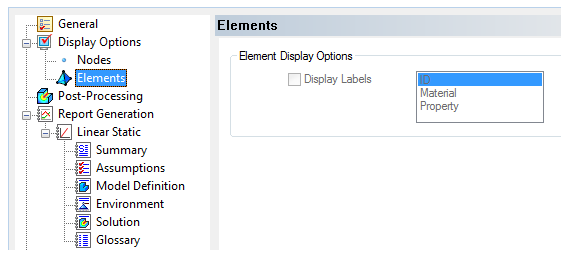

  • Display Options Elements:
    • Elements Element Display Options Display Labels – Deactivated

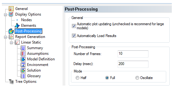

  • Post-Processing:
    • General Automatic plot updating – Activated
    • General Automatically Load Results – Activated

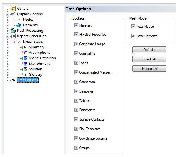

  • Tree Options:
    • All Buckets and Mesh Model options activated
