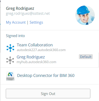

To access the connected drives from Revit, install Desktop Connector and sign into your account. See Autodesk Desktop Connector Help.
After installing Desktop Connector, the BIM 360 connected drive will display. This connected drive can be used to link or open supported file types from within Revit.
