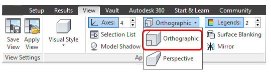

Note: It is much easier to select the surfaces of the fins if the model is displayed with Perspective Projection disabled. If it is disabled, the model should look like this. Notice that the lower edge of the air gap between each fin is visible:
If not, click View > Perspective, and select Orthographic

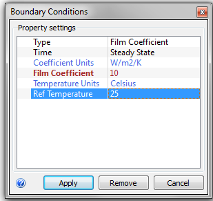

Open the Boundary Conditions quick edit dialog in ONE of the following ways:
Type = Film Coefficient
Coefficient Units = W/m2/K
Film coefficient = 10
Temperature Units = Celsius
Ref Temperature = 25
Click Apply.
