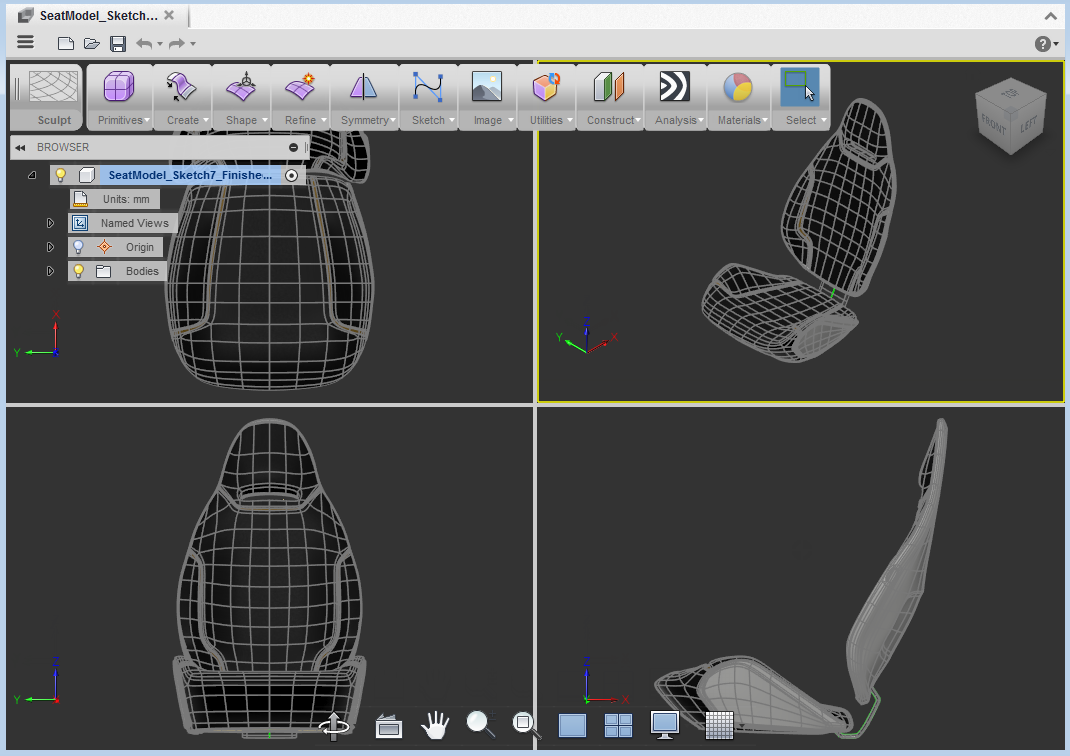

Work with views
You can display four views in the canvas. Displaying multiple views allows you to work in one view and see the changes from other camera positions.
To enable multiple views
In the Navigation bar select Multi-View.
To enable single view
In the Navigation bar select Single-View.
To resize view
You can resize the view.
  • Click and drag on the border between views to resize two views.
  • Click and drag at the intersection of all four borders to resize all four views.
To change the display style of views
On the Display Settings pull-down, select an Environment.
