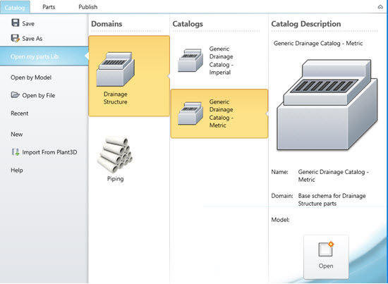

There are several ways to review, modify, and publish part families and assemblies:
  • You can work with a default library of drainage structure and piping catalogs, in Metric or Imperial units.
  • You can open and modify a parts catalog that is associated with a specific Autodesk InfraWorks model.
  • You can open a part catalog file from your local system in .ICBT format.
  • You can add new parametric parts to your library using .IPT parametric shape template files that were created with the Infrastructure Part Shape Utilties tools for Autodesk Inventor.
Once opened for edit, a draft catalog is maintained while you complete your edits. Parts Editor can reload your current edit session from the Recent Catalogs list. By default, your working Draft catalog is stored in your My Documents folder, in C:\users\username\Documents\Autodesk\Parts Editor. Draft catalogs are stored in .ICBT format with matching folders for draft parts. If you create Excel spreadsheets for size editing using the Parts Editor, they will also be stored in your My Documents folder by default.
When you are have finished an assembly in the Parts Editor, you can save your final catalogs in the My Parts library, and publish your final catalogs to Autodesk InfraWorks and/or Autodesk Civil 3D.

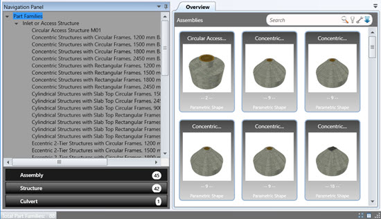

Drainage Structures
Drainage Structures are organized by Assembly, Structure, and Culvert in the Navigation Panel of the Parts Editor.
There are two different types of drainage structure assemblies you can work with: 1) Inlets & Access Structures, and 2) Culverts. Each type of part assembly is composed of multiple parts families and multiple part size variations.

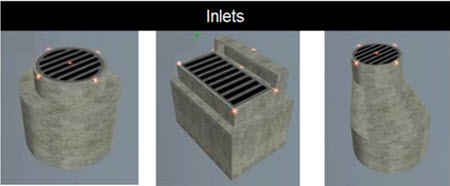

  • Inlet and Access Structures: An assembly class made up of inlets and manholes. An inlet and access structure assembles an inlet frame with an underlying catch basin structure and a cover or grate. Surface Structure parts are the Inlet or Inlet Frame base parts for Inlet and Access Structure assemblies. The sizes defined for the Surface Structure part families are the sizes that you see in the assembly. Each part size is matched to the appropriately sized Underground Structure (also known as a catch basin) and a Cover or Grate (also known as a manhole).

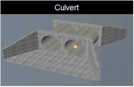

  • Culverts: An assembly class made up of Culvert Barrels and optional End Treatments for end sections such as headwalls.

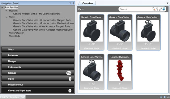

For Piping catalogs in the Parts Editor, there are many types of piping assemblies that can be created using piping parts families. For example, you can create a Fittings assembly from Adapter, Cap, Coupling, Cross, Elbow, Plug, Reducer, Lateral, Tee, and Wye part families, or you could create a Valves and Operators assembly using Hydrant, Valve, Valve Actuator, and Valve Body part families, as shown in the image below.
