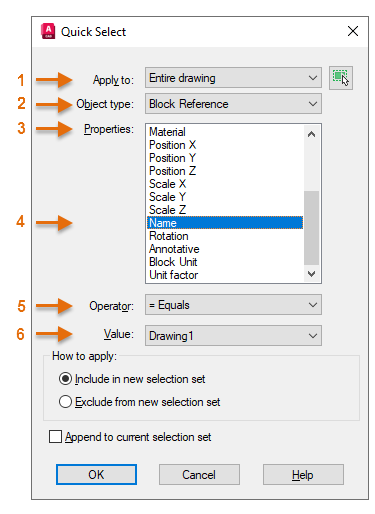

The purpose of the following steps is to create several blocks and place them on several layers.
The results might look something like this:
The specified blocks are now highlighted and included in a new selection set, and an accurate count of the specified blocks is reported in the Command window.

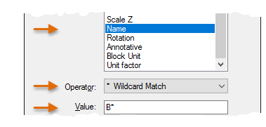

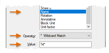

Sometimes you'll need to count blocks using a general name pattern. The most common wildcards used are "?" for a single character and * for any number of characters. For example, you can search for all the blocks beginning with the letter B using B*, and all the blocks that have 4 as their second character using ?4*.

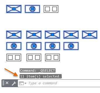

All blocks beginning with B are selected as shown below.
Once again, an accurate count is displayed.
All instances of blocks A410 and B464 are selected and an accurate count is displayed in the Command window.

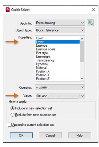

To count all the blocks on a specified layer, follow these steps:
All the blocks on layer 001 abc are added to a new selection set, and the block count is displayed.

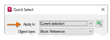

Currently, all the blocks on layer 001 abc are selected. Notice that the Apply to field has automatically switched to Current selection as shown below.
This means that only the current selection set will be used rather than the entire drawing.
