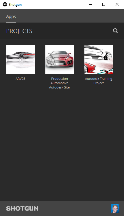

Open Shotgun Desktop and see the Projects tab with all projects assigned to you.
Click a project to access the pipeline for that project.

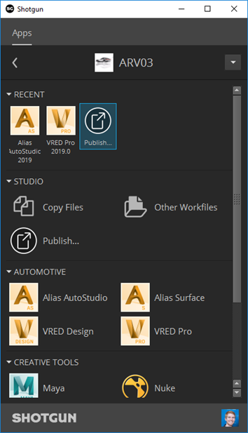

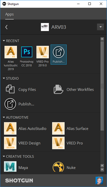

If your project uses the standard Automotive Project Config, you will see the following headings. Please note these headings can be configured to meet your needs.
Recent: Displays recently used software and options. Once a tool from the Studio or Creative Tools sections is used, it appears here.
Studio: Displays software, such as Copy Files, File Manager, and Publish options. This is a common place for Python applications specific to your studio.
Automotive: Displays software, such as versions of VRED and VRED, installed on the current machine.
Creative Tools: Displays software, such as Maya, Photoshop, and any other compatible creative software, installed on the current machine.
