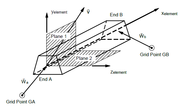

X1, X2, X3 Components of vector , from GA, in the displacement coordinate system at GA (see Figure 1). Real or blank
G0 Grid point identification number to optionally supply X1, X2, and X3. Direction of orientation vector is GA to G0. Integer or blank

Figure 1: CBAR element geometry

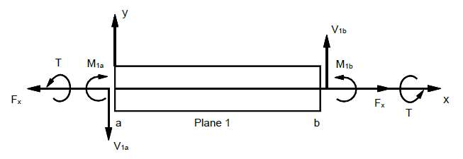

Figure 2: CBAR element internal forces and moments (x-y plane)

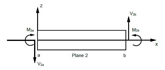

Figure 3: CBAR element internal forces and moments (x-z plane)
