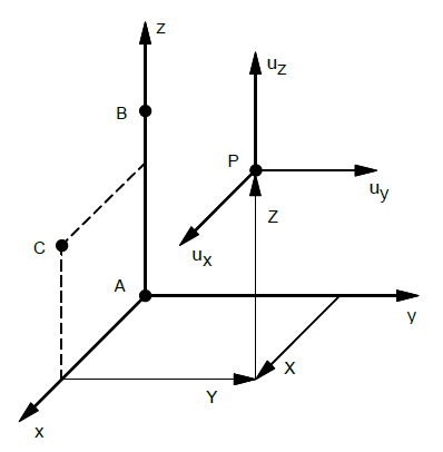

Description
The CORD2R entry defines a rectangular coordinate system with the coordinates of three points.
Format

Figure 1: CORD2R definition
Remarks
- Continuation entry must be present.
- The three points (A1, A2, A3), (B1, B2, B3), (C1, C2, C3) must be unique and non-colinear. The model translator checks for non-colinearity.
- Coordinate system identification numbers on all CORD1C, CORD1R, CORD1S, CORD2C, CORD2R, and CORD2S entries must all be unique.
- The reference coordinate system must be independently defined.
- An RID of zero (or blank) references the basic coordinate system.
- The location of a grid point (P in the sketch) in this coordinate system is given by (X, Y, Z).
- The displacement coordinate directions at P are dependent on the location of P as shown above by (uX, uY, uz).
