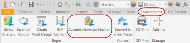

    • In Inventor, click Environments Autodesk Inventor Nastran to enter the Inventor Nastran environment. The browser automatically shows the Autodesk Nastran Model Tree, although you might need to select its tab in the left pane to see it.

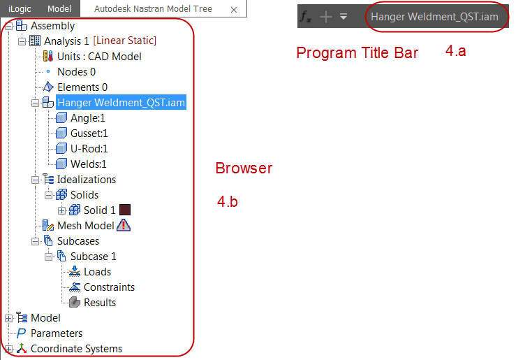

  3. To make sure that you have successfully set up the analysis model:
    1. Verify that the new model name (with _QST added) is shown in the CAD program title bar.
    2. Verify that the browser is showing the Autodesk Nastran Model Tree.
