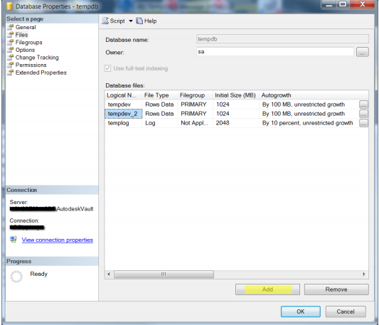

  3. Right Click on tempdb and select properties.
  4. Select the Files page.
  5. If using a multi-core system, additional data files should be configured, using the guidelines below. If using a single-core system, skip to step d below.
    1. Data file totals should equal half of the available physical processing cores - up to a maximum of 8 data files. (example; 8 physical cores would equal 4 total data files, tempdev, tempdev_2, tempdev_3, tempdev_4).
      Note: In case of SQL 2016 or later, Data file will default to the lower value of 8 or number of logical cores as detected by setup. The value can be increased as required for a specific workload. The file names for secondary data files will follow the tempdb_mssql_#.ndf naming convention where # represents the file ordinal for each additional file.
    2. Click the Add button to add additional data files.
    3. Name the new file(s) tempdev_2, tempdev_3, … as needed.
    4. Set initial size of each data file to 1,024 MB. If using a total of 8 datafiles, an initial size of 512 MB can be used.
    5. Set Autogrowth to 100 MB, unrestricted growth for each data file.
    6. Set the LDF log file to combined data file total. (example; if there are 2 data files total, the resulting LDF should be set to an initial size of 2048 MB)
    7. The results will appear similar the image below.

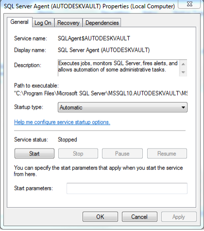

  3. From the Control Panel, double-click Administrative Tools and then double-click the Services icon.
  4. Locate the SQL Server Agent (AUTODESKVAULT) service
  5. Right-click on the SQL Server Agent (AUTODESKVAULT) and select Properties.
  6. . Change the Startup Type to Automatic and start the service.

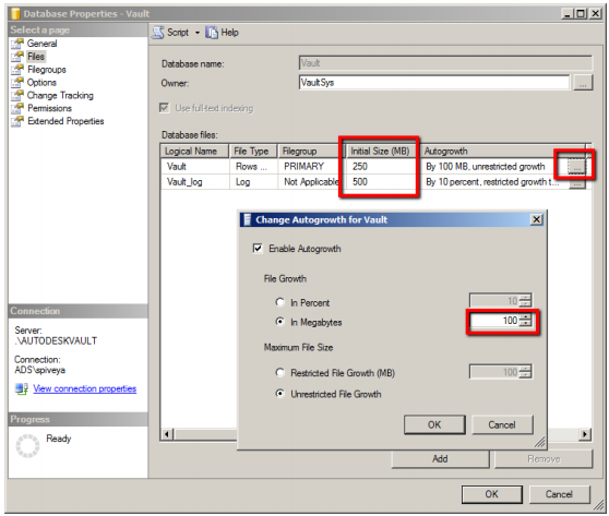

  8. Right-click on the Vault database and select properties.
  9. On the Files page set:-
    • the Autogrowth value for all <Vault> databases to by 100MB, unrestricted growth
    • the Initial Size value of all <Vault>_log files to 500MB
    • the Autogrowth value for an <Custom_Library> files to 25MB
    • the Autogrowth values for all _log files to By 10 percent, unrestricted growth
